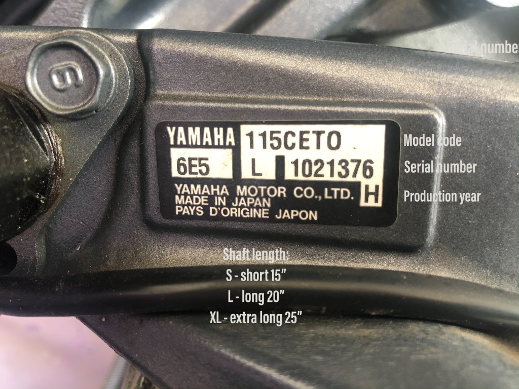

Yamaha tabela rocznika
D - 1990, C - 1991, B - 1992, A - 1993, Z - 1994, Y - 1995, X - 1996, W - 1997, V - 1998, U - 1999
T - 2000, S - 2001, R - 2002, Q - 2003, P - 2004, N - 2005, K - 2006, J - 2007, H - 2008, G - 2009
F - 2010, D - 2011, C - 2012, B - 2013, A - 2014, Z - 2015, Y - 2016, X - 2017
https://www.stonescornermarine.com.au/n ... -outboard/
yamaha.jpg [ 216.95 KiB | Przeglądane 66454 razy ]
https://www.huntsmarine.com.au/pages/yamaha-year-models
