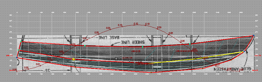

odpaliłem Free!shipa i zamodelowałem kadłub. Po Calculation dostałem:
Design length : 3,800 m
Length over all : 3,595 m
Design beam : 0,400 m
Beam over all : 0,330 m
Design draft : 0,314 m
Midship location : 1,900 m
Water density : 1,025 t/m^3
Appendage coefficient : 1,0000
Volume properties:
Displaced volume : 0,118 m^3
Displacement : 0,121 tonnes
Total length of submerged body : 3,482 m
Total beam of submerged body : 0,318 m
Block coefficient : 0,3392
Prismatic coefficient : 0,5761
Vert. prismatic coefficient : 0,5149
Wetted surface area : 1,962 m^2
Longitudinal center of buoyancy : 1,687 m
Longitudinal center of buoyancy : -1,581 %
Transverse center of buoyancy : 0,000 m
Vertical center of buoyancy : 0,214 m
Midship properties:
Midship section area : 0,059 m^2
Midship coefficient : 0,5888
Waterplane properties:
Length on waterline : 3,482 m
Beam on waterline : 0,318 m
Half entrance angle of DWL : 7,524 degr
Transverse moment of inertia : 0,004 m^4
Longitudinal moment of inertia : 0,410 m^4
Initial stability:
Vertical of transverse metacenter : 0,250 m
Transverse metacentric radius : 0,037 m
Longitudinal transverse metacenter : 3,696 m
Longitudinal metacentric radius : 3,482 m
Lateral plane:
Lateral area : 0,878 m^2
Longitudinal center of effort : 1,671 m
Vertical center of effort : 0,182 m
Hull characteristics above waterline:
Lateral wind area : 0,832 m^2
Z coordinate of wind area CoG : 0,433 m
X coordinate of wind area CoG : 1,770 m
Distance from wind area CoG to DWL : 0,105 m
Distance from bow (FP) to wind area CoG : 1,728 m
Minimal board height over DWL : 0,250 m
Minimal board height over DWL : 6,954 %Lmax
Stability characteristics:
Test stability coefficient : 3,235 if >= 0,8 then OK
The following layer properties are calculated for both sides of the ship:
| Layer | Area | Thickness | Weight | COG X | COG Y | COG Z |
| | m^2 | mm | tonnes | m | m | m |
| Layer 0 | 3,663 | 0,000 | 0,000 | 1,713 | 0,000 | 0,295 |
Attention: Weight of a ship and displacement are difference more then 10% !

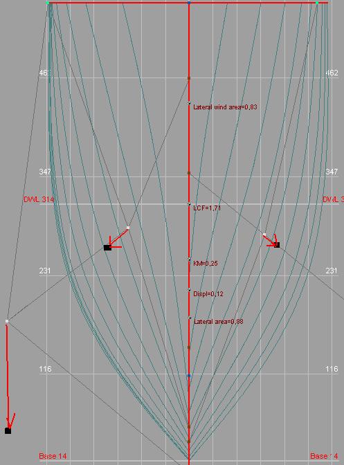

Czy policzona wypornosc odnosi sie do zanużenia DWL=31,4 cm z rysunku powyższego? Co to jest LCF=1.71? Co to KM=0.25 i Displ = 0.12?
Co oznaczaja cyferki obok niebieskich kółek z rysunku powyzej?
Takie mi wyszlo rozwinięcie.
Powierzchnia boczna jednego kadłuba to 3,6m2, czyli na dwa wyjdzie 2,5 arkusza sklejki + sklejka na górę. Masa jednego kadłuba, przy założeniu samej sklejki 4mm (14kg na m2) to 50kg, czyli dla dwóch kadłubów i masztu załóżmy 140kg - 240 wyporność dla 31.8 cm zanurzenia zostaje 100kg - trochę mało? Chyba, że gdzieś tkwi błąd? ;)
Disp - wyporność części poniżej DWL
KM - wysokość metacentryczna http://pl.wikipedia.org/wiki/Wysoko%C5% ... centryczna
LCF - Longitudinal center of effort - po prostu środek ciężkości.
ŁJ
A co to za sklejka? z blachy że waży 14 kg/m2? sklejka waży ok 600kg/m3 czyli 2.4 kg/m2 sklejki o grubości 4mm.Przelicz sobie wagę jeszcze raz.
