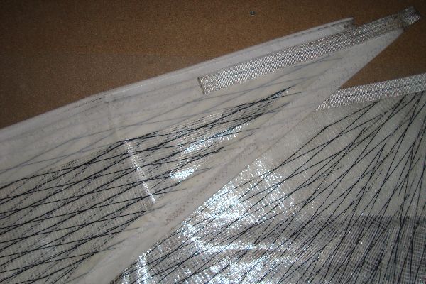

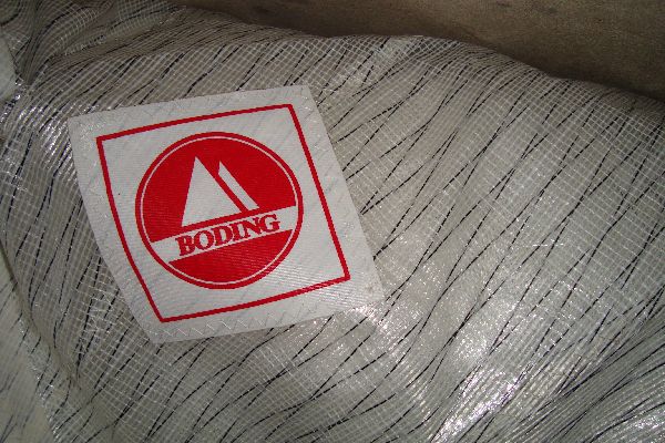

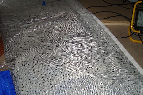

A oto i żagiel. Zatem co to za materiał?

Polyester X-PLY® Line
http://www.gourock.co.nz/uploads/catalo ... e%2010.pdf
